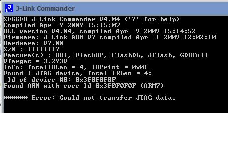

« Reply #7 on: May 11, 2009, 11:50:00 11:50 »
hi all,
when i connect j-link to my ARM7 board, the error orrcured as following (see image):
« Last Edit: May 11, 2009, 11:54:22 11:54 by thavali » Logged
