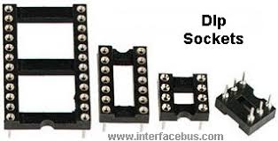

@Yukine Given that you are working with DIY boards. If you route your own boards and use through hole compoents. You can use the compents leg as via. This works good for components like resistors, most ceramic capacitors, tantalum capacitors, and through hole ICs. Also works on DIL sockets of this type. These sockets cost somewhat more but not that much.
Edit: Just to sure. I did not meant using cut of components leg as via (although that also works) But in the design process changing from top to bottom layer at sutiable components legs as often as possible. Instead of creating a via
