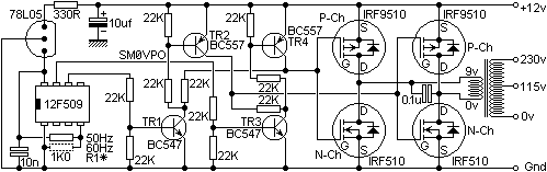

Here is a small project with PIC12F509 to drive an inverter 12v/220v.
To have good sinus, it is necessary to filter output.
http://www.sm0vpo.com/power/pic_dc-ac_01.htm
Source is available on web site.
Best Regards.
