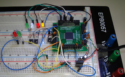

« Reply #3 on: February 01, 2011, 05:06:00 17:06 »
Any here have success on build a PIC32 board? My PicKit2 cant detect my board, I using a PIC32MX795...
Sideshow Bob
Posts: 1027
-Given: 235
-Receive: 1006
« Reply #4 on: February 01, 2011, 06:34:15 18:34 »
Take a look here http://www.microchip.com/stellent/idcplg?IdcService=SS_GET_PAGE&nodeId=1406&dDocName=en027813
As you can see your Pickit 2 do not support your device. You have to get a PICKIT 3 in order to program your chip (I think).

Anunakin
Inactive
Posts: 3
-Given: 3
« Reply #5 on: February 01, 2011, 08:20:17 20:20 »
Thanks!
I found there is a PK2DeviceFile.dat (pk2cmd) editor here:
http://www.microchip.com/forums/m473925-print.aspx
And need add it to .dat file:
Quote
First duplicate item PIC32MX460F512L from the parts list then change to these
settings:
PartName: PIC32MX795F512H
DeviceID: 0x0000E000
ProgramMem: 0x00020BFC
For PIC32MX795F512L
Quote
PartName: PIC32MX795F512L
DeviceID: 0x00007000
This works now...  Grin
« Last Edit: February 02, 2011, 02:05:00 14:05 by Anunakin » Logged
Anunakin
Inactive
Posts: 3
-Given: 3
« Reply #6 on: February 24, 2011, 12:47:51 12:47 »
I made my own PIC32 kit! with a PIC32MX795 sample and a TQFP 100 adapter, spent about U$ 1.50 !  Grin
I using USB HID Bootloader from UBW32 and Pinguino32X (svn restrict version), compiler is C32 all Linux env.  Tongue
more here:
http://www.vivaphp.net/2011/02/pinguino32x-minimum.html
