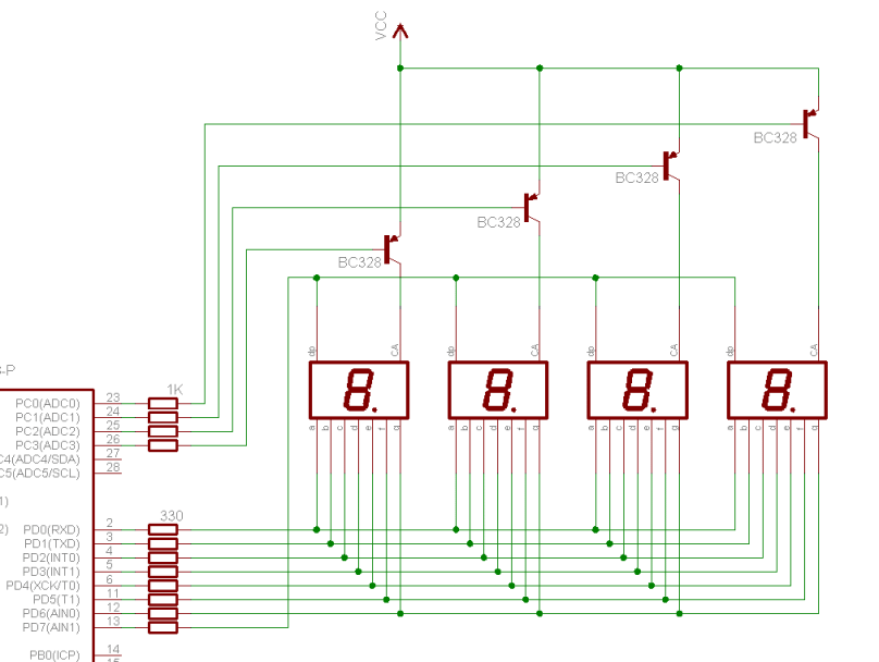

« Reply #5 on: April 06, 2008, 06:39:58 18:39 »
yes nice project but the display system is not very good
why you don't have used like this schema
it is more easy to build and low cost
goslock
Posts: 13
-Given: 12
-Receive: 7
« Reply #6 on: April 08, 2008, 04:40:27 04:40 »
You have reason in the diagram is easier multiplexed, but I forgot to add that in the second diagram, just what use to simulate as it does not include ahi the power part because the display work from 7 to 9 volts and try to use multiplexacion but had some problems with the sampling keyboard as input data, why use the records and then hand power to ULN2803. That was the reason.
