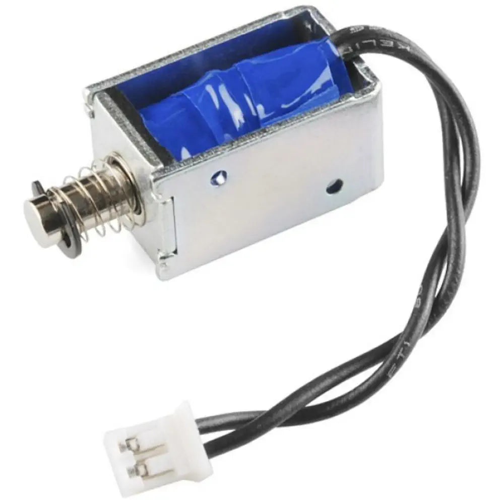

Hi Folks,
I am look for fast Push-Pull Solenoids ( turns on-off) for my project. My requirements is to be able to reach 30-50 Hz (ON-OFF rate).
I don't have any requirements on stroke length. stroke length of 1cm shall be Ok for me.
The internet is full of Chinese solenoids as picture below :
I didn't find any datasheet for their maximum frequency. I only found one video that claims fast switching but this doesn't even come close to my 30Hz requirements.
I kept searching for other options and I found this product : https://www.youtube.com/watch?v=TB17BLS7cMM
The actuator seems very promising but price is not affordable for my small project.
My question, did anyone had good switch-rate with the Chinese solenoids? what max frequency could you achieve ?
any cheap alternatives ?

Considering the very low cost of such devices, like you show pictured, if it were me, I would buy one and see how fast I can get it to work by trying it out.
Improving its speed, may be as easy as a brief overdrive pulse... you could just try one. These are crazy cheap.

30Hz, no requirements on stroke length - what's the intended application?
I have a hard time to envision that such cheap solenoid might be capable of fulfilling 30H-50z mechanically, and delivering "some" mechanical travel.

You may use dither to help making solenoids switch faster.
By applying a dither signal, you help improve things like static friction, response time, positional accuracy and hysteresis effects.
Typical Ranges:
Hydraulic proportional valves: 50–400 Hz
Small fast-response solenoids: 200–1,000 Hz
Larger industrial solenoids: 20–200 Hz
The frequency and amplitude of the dither signal should be carefully chosen.
1/ The dither frequency should be high enough that it does not interfere with the solenoid’s main switching operation but low enough to effectively reduce static friction.
2/ If the amplitude is too high, the solenoid may oscillate excessively, leading to noise, heat, and wear.
3/ Often 5–15% of the full control signal voltage or current. These may need to be adjusted experimentally for best results.
Tuning:
1/ Start with a low amplitude (~5% of control signal) and a moderate frequency (~100–200 Hz).
2/ Gradually increase frequency until friction reduction is noticeable, but avoid excessive vibration.
3/ Adjust amplitude to find the minimum level that still provides effective dithering without unwanted oscillations.
4/ Monitor performance (response time, heat, noise) and fine-tune accordingly.

« Reply #4 on: February 22, 2025, 08:14:09 20:14 »
@optikon
overdrive pulse might help a little bit but wouldn't improve the speed that much. The return spring shall be changed to provide faster return to initial position.
It will be a complete redesign to the solenoid if it doesn't reach 30Hz naturally...
@ur63
I am planning to use it for laser galvanometer. this shall be a bang-bang control system for deflecting mirrors.
@PM3295
I am not sure about what you exactly mean by dither. can you please provide some references?
