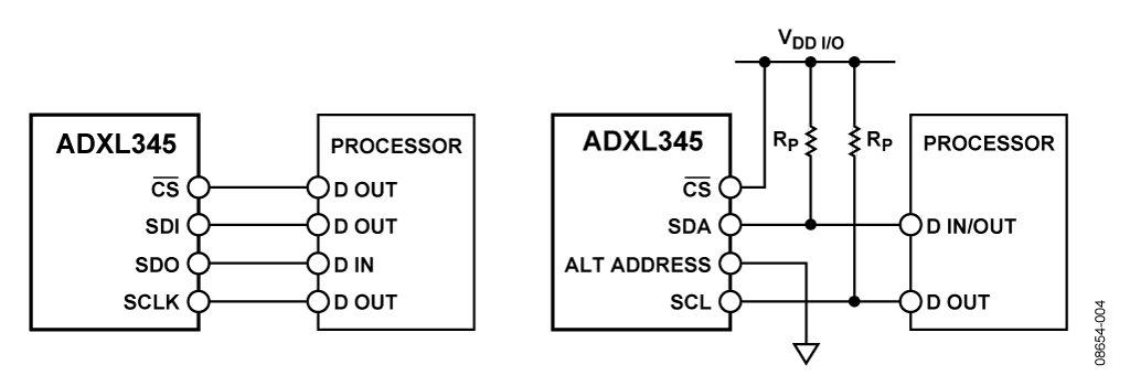

Related to the acceleration sensors, many questions unanswered in the forums and saw the unfinished work. Codes associated with acceleration sensors, I'll be posting the help of the codes used in the forums.
Some mathematical formulas taken from their pdf files of the acceleration sensor. Some numbers, because it does not allow the processor bits I wrote using the appropriate numbers. CCS C is very efficient in this regard. 8-bit inefficiency is able to absorb ("math.h"). Proton and Picbasic Pro may be errors. I'm glad you publish corrections.
We may in the future use of these codes to balance the robot and share code.
Good work everyone.
This codes works fine for me.

Symbol SDA = PORTD.0        'I2C data pin. Pullup connection is required.
Symbol SCL = PORTD.1        'I2C clock pin. Pullup connection is required.
