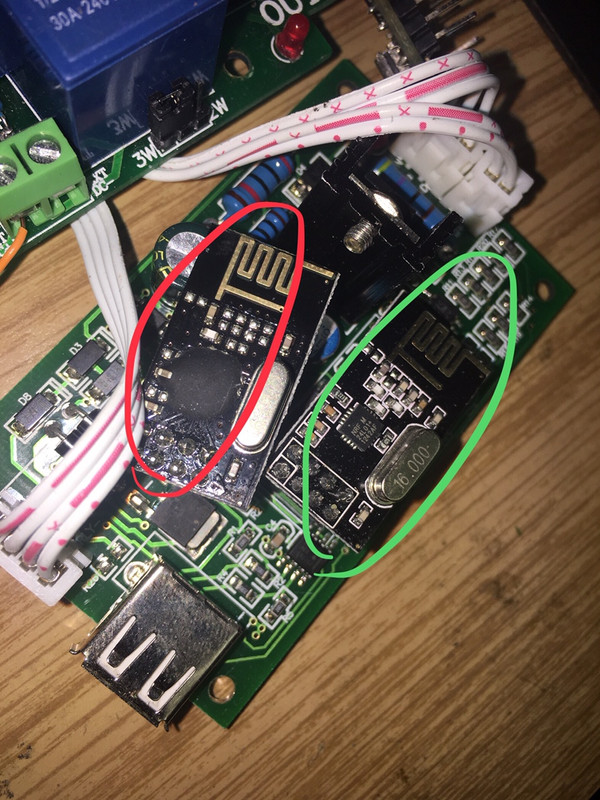

This device works fairly well.  Downsides are it doesn't include a dc-dc converter to self power from the high voltage input and the included radio transceiver has a range of about 1 meter (rather than the claimed 10)
https://www.ebay.com/itm/DC-500V-100A-200A-500A-Wireless-Voltmeter-Ammeter-Coulometer-Battery-Power-Meter/132928693409
But, it uses the nRF24L01 radio transceiver chip so the radio module can be swapped with this to extend the range to at least 100 meters:
https://smile.amazon.com/gp/product/B07GRMJJY5
If you know of a pin compatible drop-in replacement that works at lower frequency (915, 433, 315 mhz, etc.), please let me know.

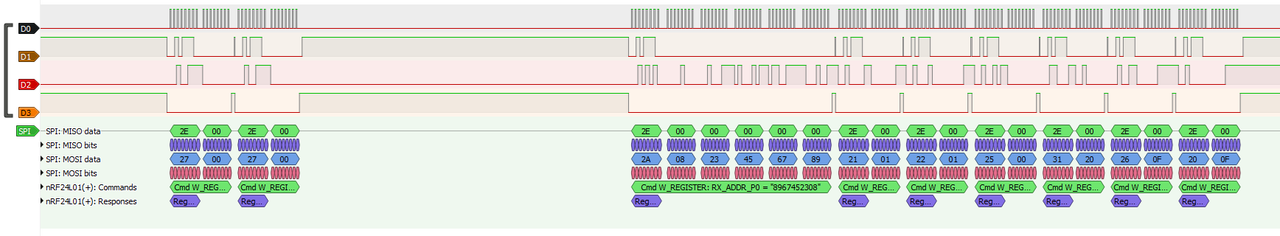

I got a few as well (3 in use), works great, just a few days ago managed to connect to with Arduino and now with Raspberry pi, planing to make a better GUI for all 3 in 1 3.5" pi display.
First I was snooping the SPI init to see hows the NRF24 gets initiated and whats being transmitted, got a lots of info, once I got the RX_ADDRESS the rest was easy with RF24 lib available for Linux Pi and Arduino
Code:
RX_ADDR_P0=89674523  -> 08 is the channel
The poor range is due to the fake cheap NRF chip and many missing component from the RF side, once I replaced it with a good quality module its works as expected.
