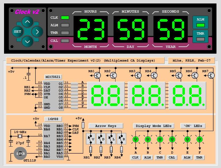

Another similar solution:
http://www.electro-tech-online.com/imgcache/3539-Clock-2v2.jpg
Of course you must use hifher supply voltage.
Instead MIC5821 you can use equivalent chip UCN5821.
« Last Edit: September 16, 2014, 08:11:40 20:11 by dennis78 » Logged

« Reply #9 on: January 21, 2015, 02:49:41 14:49 »
Quote
I am searching for the software used to draw this schematic, but unable to find.
Can anybody tell me which software is that?
Regards,
Thiru

« Reply #11 on: January 22, 2015, 05:17:53 17:17 »
I think i ever read somewhere some years ago that diagram is not drawn using any EDA software, but Visio (or similar) - but maybe my memory which is full of noise now Smiley.
