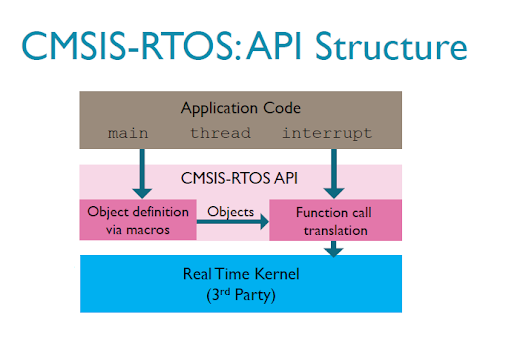

You can use CMSIS-RTOS api with RTX RTOS. CMSIS-RTOS API supported by some RTOSes. if you need, you can easily change rtos library.. API is the same for your perpective.. only static library will be changed on link time.

I think any RTOS is a great choice and code will become cleaner, but use an "OS" abstraction layer so you can easily change RTOSES in the future. Start with free one of course.
Look at what debug support for whatever IDE you use to help check task stacks , timers and mailboxes etc.
Many examples of abstraction layers on NXP, ST sample code.
Good luck
Good luck
CMSIS-RTOS api is also abstraction layer..

I'm the fan of FreeRTOS; it is fairly generic and seem to be the good standard for all ARM. CMSIS compliant version that comes with STM32Cube is also compatible with other Cortex platform. Different memory allocator allows me to tune per application, and debugging is also straight forward with gdb. Thread implementation is also reasonable with good set of common primitives.

2. Whether you working with Cortex micro (probably most of us) use CMSIS - RTOS rapping
